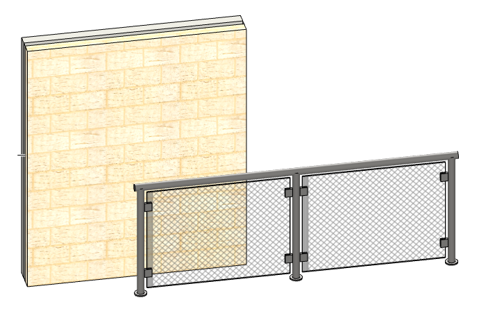

I'm trying to have a railing for my balconies with a fence.
I did a material is working good in 3d. I did manage to have the material transparent on front views. But I have a problem. In the background I can see only the line of the window for example e not the color of the window frame. Everything will be covered with white. Do you have any tip?

Thanks for your reply. Yes it's similar to this post. I've found a solution 🙂
During a course I remember that the tutor says that demolition surface in archicad is a really particular material.
So I started to make a copy of this surface and then applying a fill for it. It works now I'm able to see trhought the fence and the colors behing and material looks great.
So I suggest to everyone to start with a copy of demolition surface and then the background of your material will be totally transparent on your facades.
The negative thing is that in 3d will be totally transparent. Any suggestion? I understand that the transparency matter but why if you below it to 100 then in front view it's not working anymore?

I'm using a railing tool, with transparency 100 we can get what we want. But then the texture will be not visibile in 3d. I need to use a vector 3d method to see the fence in 3d view but It's a little bit heavy as style.
OK, you mentioned a 'fence'.
I thought you might be using a fence object.
You just mean a fence material like chain-link.
Vectorial 3D does not show the textures, only the hatches.
Set transparency to 51% - any lower it will be solid.
The same view with hardware acceleration engine that does show the textures.
In elevation you will still have transparency if that is turned on in the elevation settings.

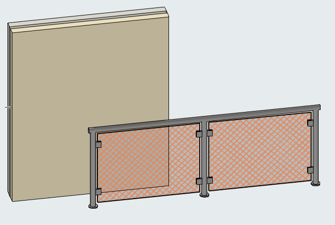

Another option that I'm trying is to have a graphical override for it and I have two more question:
-Is it possible to apply a GO just for a panel? I'm trying to sort it with a rule based on classification but I don't succeed
-Right now what is displayed is the surface that i have assigned to surface material. Is it possible to set that is not aligned with the slope?
Thanks in advace, Matteo.
GOs will apply to the entire railing object.
Unfortunately you can just apply to the panels.
Yes the panel material will align with the railing slope.
