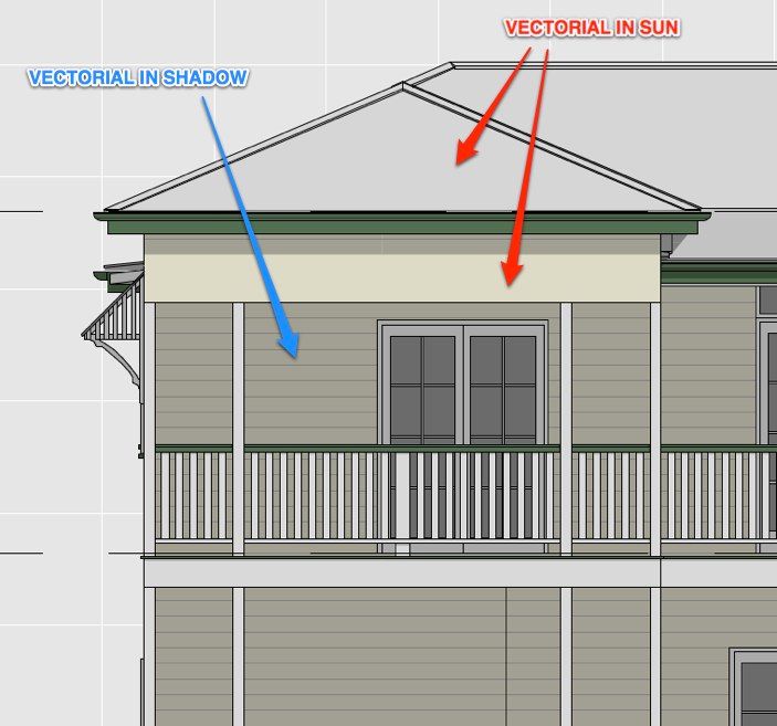

I'm having an issue with one particular project where the vectorial hatching in a coloured elevation is only visible in shadow. If shadows are turned off there is no hatching at all. I seem to remember having this issue years ago but I can't remember the solution or if there was one.
Any thoughts would be appreciated, as I am looking to avoid merging the project into a new template file.
2 REPLIES 2
Solved. Had a model view option set to override cover fills. Strange though that the vectorial hatching is visible in shadow.

Yes, that is a bit inconsistent with what one might expect. I reproduced the condition on my end. I guess someone might use this to add visual effect to an elevation but I will report this to our developers. Glad you got it sorted!
