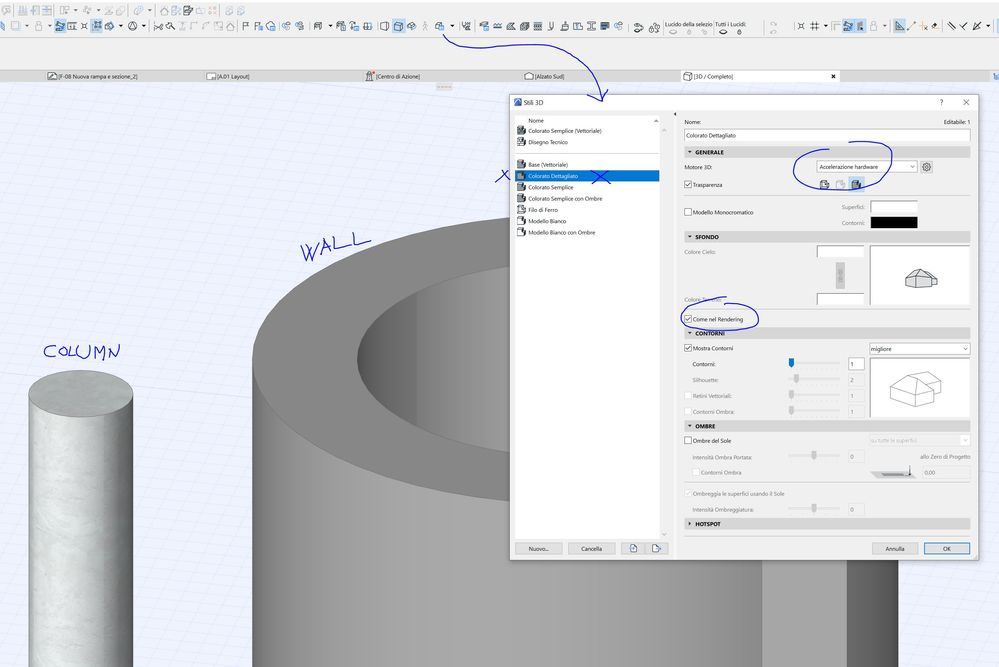

It is my first post in this precious forum. I am starting to use Archicad after many years of Revit. And I'm a bit panicked 🙂 For example, using the Morph tool, I found that the program, drawing a cylinder, creates a surface divided 36 times, therefore polygonal! I saw that if I have to fillet a corner of a solid, you can choose the number of segmentations, that's a good thing, but the cylinder remains segmented ...

I dont want to see the 36 segment-faceted circular column in my 3d or planar views 😞

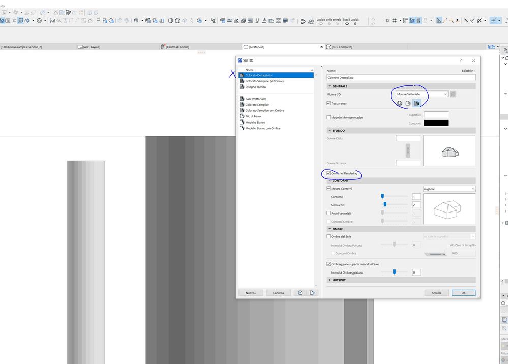

In my case, I can only change the display settings if I am in a 3d window, if instead I am in a section or in an elevation I cannot ... How to do it?

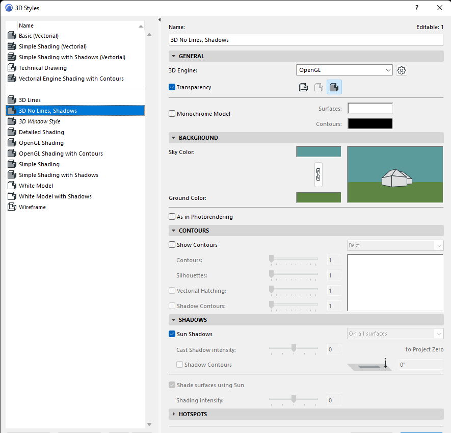

In a 3D window, if instead of "vector engine" I insert "hardware acceleration", the circular wall improves a lot, while the 36-sided circular column always remains. In the elevation views, nothing changes: the curves are always faceted, but I can't even change the graphic display, switching for example to all white etc .....
3dview settings.JPG3dview settings_vector.JPGElevation settings_acc hardware.JPGElevation settings_vector.JPG
you will always see the segmentation with vectorial engine. if you use the open gl then you wont have issues. 2.png

Ok, in the 3D Window these settings work: when I put OpenGL the curves are more nuanced and soft, you always see the segments, but very little. If I put the vector motor they come back to see themselves very flashy (like in my previous images).
Instead I can't change the situation in Elevations and Sections 😞
hmm can you share a screen shot of the elevation or section?
even if i show a wood column with timber variation i dont get extra lines. jus the outer lines you expect to see.
Unabend
Hello Seneca! See my previous post wit 4 images (2 axonometric and 2 elevations)...
