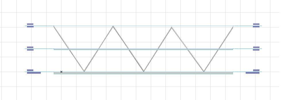

I HAVE A PRBLEM WHILE MODELING THIS ELEVATION
I NEED TO MAKE A GLAZE WINDOWS TTO THE TRUSSE BETWEEN THESE TRUSSLIKE COLUMN
ARE THERE ANY IDEA FOR IT HOW CAN I FILL THESE TRUSSES WITH GLASS?

Draw a single wall of glass through the truss. You can then use Solid Element Operations to subtract the truss elements from the glass, although this might not be necessary, depending on the result you want.
i'll try it thanks for your help
