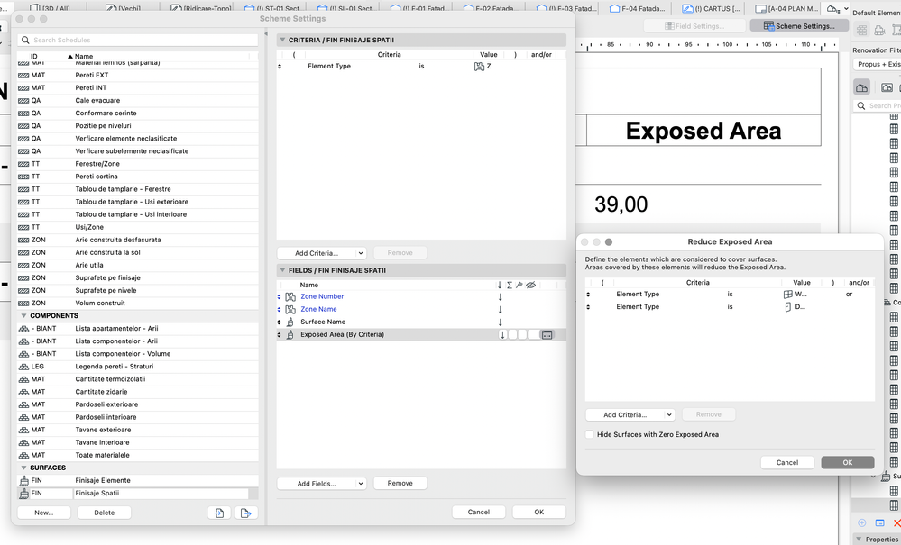

Hello,

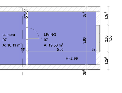

I am trying to extract the finishes for the zones in my project. I use a Surfaces schedule. It works fine, it inherits the finishes of the walls, the cropping objects precisely. The problem is — I cannot convince Archicad to subtract the areas of the doors and windows, even if I use the „Reduce exposed area“ menu/window.
If I visualize the zone in 3D, I see it with the wall finishes, but I cannot see „through the windows“ in the room — the surface is not interrupted.
Any helpful suggestions are very valuable!
Thank you in advance!
Nic

Can you show your Scheme Setup Dialog (criteria and schedule fields), and maybe also a 3D View of one of the Zones and its surrounding Walls that shows what the expected Surface values are, plus the generated Schedule that shows what the schedule displays?

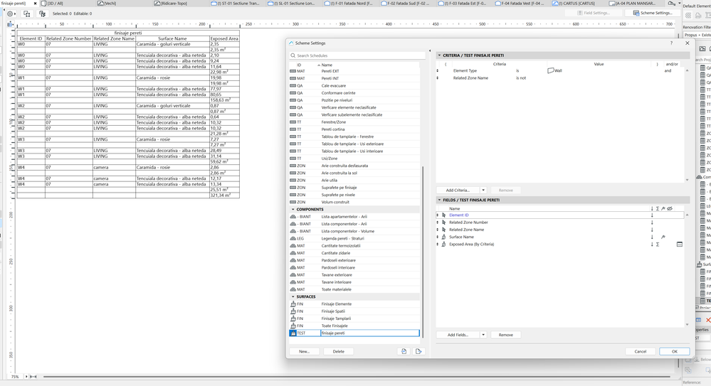

Nic Tulban
Hello Laszlo,
thank you for your quick response.
Here you may find the images.
What bothers me is that there is no „hole“ in the zone where the window is…

Nic Tulban
Thank you, Laszlo.
It works, but not precisely. The filter works at the entity and not at the surface level.
Then comes an apparent misfunction in the "Reduce Exposed Area" filtering. I get the masonry surfaces ('Caramida - rosie') in the list even if they are completely covered by the neighbouring walls.
I attached the new list, built on your suggestion. If I misunderstood something, plese be so kind to correct me.
Lot of Thanks,
Nic
