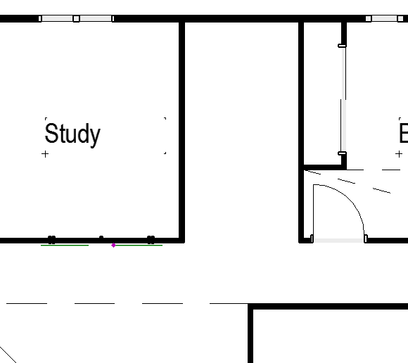

I am currently working on a house and trying to just have plain black walls for the SD set.
I have changed the Cut Fill Background Pen to a black which changes the walls to be black, however some types of doors I put in dont show up well, they are just all black basically.
Is there a way to have the door openings show up in a lighter colour?
Ive attached a photo of some doors and windows looking fine, but the double slider I have selected for example shows up all black.
Thanks.
2 REPLIES 2
Also due to this being an alterations and additions, I am using the existing, demolish, new renovation features.
I just tried changing a door to existing and it looks like id want it.
What can I do to have it look the way I want it while its on the 'New' status.
Hello, check in the renovation filters Graphics.
