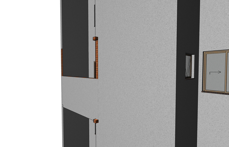

Hello,
I´m having a problema with a certain wall junction in 3d. I´ve tried to redo the junction, deleted the walls and made the connection again but the problem persists.
Please modify archicad version you are using, and check some following points may will help your problem:
1- check the layer ( these wall same layer or not) it different layer please check the number of layer
2- check the story of wall ( should be same story)
3- check the number of wall in that position ( if there are 3 wall 2 wall will connect automatically and the last one will not connect
