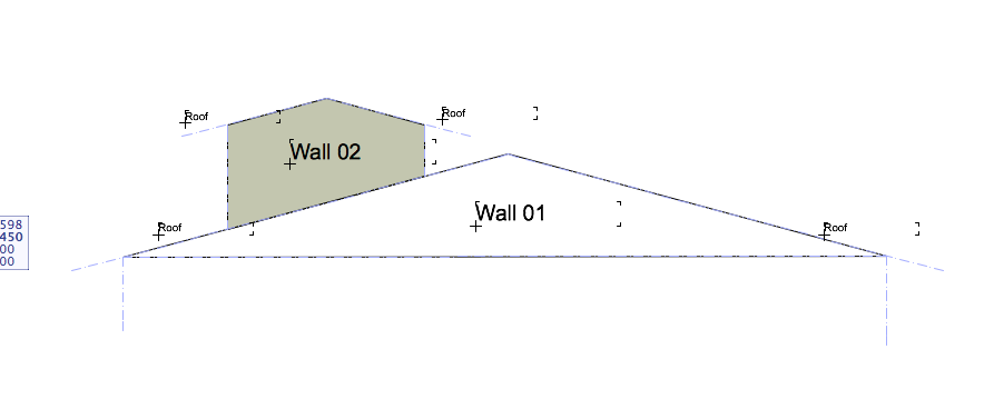

Walls and roofs.
Hey guys, it seems simple but I'm having a hard time here.
I want to make that "wall 02" separated from "wall 01" ok?
But I fitted to the roof below and I cannot get it to fit to the roof above.
There is another solution?
PS: I need the wall in my schedule to show like a wall.
Thank you.

If you're doing trim to roof, just hide the lower roof by shutting off its layer leaving the upper one visible then do the trim to roof command. You can also SEO with upwards extrusion.
Nope, I did it trim to roof in the inferior part and it does not work for the top.
Have to use SEO. šŸ˜ž
I thought there must be an simpler way.
Thank you.

You must do 2 separate trims whether you use SEO or Trim-to-Roof. Once to select the wall and roof below to trim the bottom of the roof, and then again select the wall and the upper roof to trim the top of the wall.
