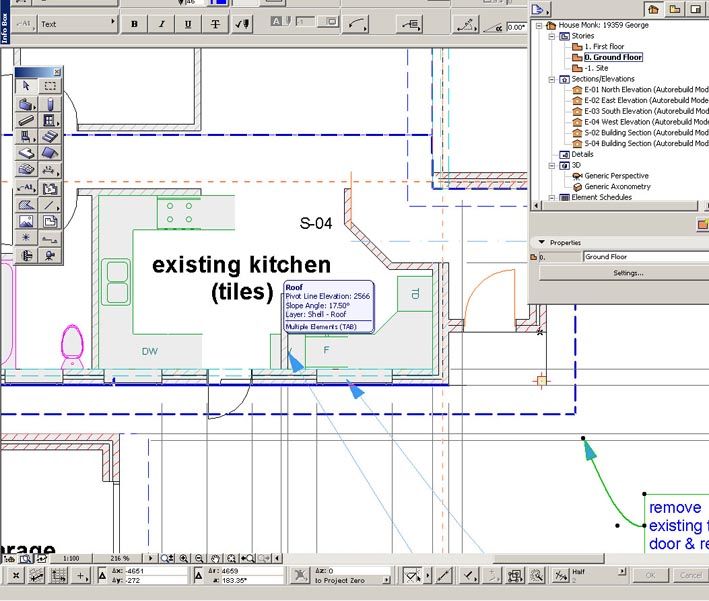

Been working on this project for a while & all of a sudden everything is filled with grey (see screenshot). When I look at my layouts it is not there & does not print but I find it a bit bothersome.
What button where please gurus?

Henry wrote:Hi Henry,
Try Options > Work Environment > More Options and uncheck "Automatic Pen Color Visibility Adjustment" box.
Cheers.

thanks Adytc. worked like a charm.
