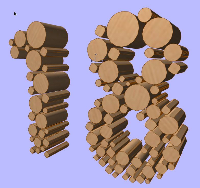

What can I do to make my 3d fonts smoother ?
Is there anything I can do to smooth the curves of a 3d font ?
I want to convert it into a morph and use it as an SEO to cut a pattern in to something.
The font is called Bubbles rising. I need all of the bubbles to be rounder. in the regular font the bubbles are all very round but not perfectly round.

Steve:
Have you tried increasing the Resolution under Parameters > 3D Representation > Resolution?

No. I couldn't seem to find it at the time.
Fond it. That is what I needed. I was able to use it for cutting the holes. Thanks.
