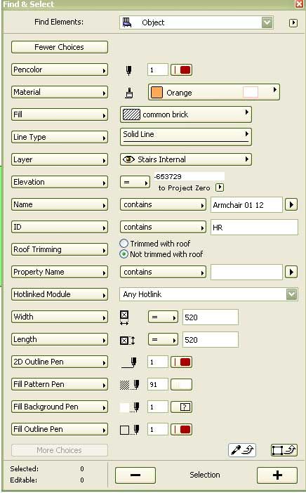

I would start filtering by Object name in the Find & Select Dialog.
I know I have seen it before but at the moment I have searched but can't find Find and Select.
Oops. Ignore me. Just found it.
Will go play now and see what happens.
What a great tool! Wish I'd known about that earlier.
But how to use it?
I've asked it to select objects. There are 1300 of them (!) and I tried to filter down even more by selected ones in the material I think may be the culprits. But it still says 1300 instead of, say, 40.
Wokka
Object name, colour, size, section fill etc etc.
Lots and lots of filtering available.

Wokka - it won't let me filter further.
I asked for 'Objects' and then asked for the choice of material "evergreen" cause I know I have some objects with that material. But it still highlights ALL objects.
Am I using this tool wrong?
I would use the 'halving method'.
Make a copy of your file. In this copy delete half of the elements, and check. If it is gone then the error is in the this half. Delete again half of the objects and check if the error occurs. Note that you will always press stop instead of continue.
Wokka
click the material button for more options.
Have a play with it and check the manual.

I think I fixed it!
I gave up on the filter. I couldn't work it out.
So I combed through the ENTIRE plan section by section using the marquee until I got it down to only a small section showing the polygon error. I then systematically removed each element within that marquee to see which made a difference.
Stupid truck!
Very tedious and slow and I am sure there was a quicker route to take, but hey!, thats the story of my life.
PS. I had to laugh when you said to check the manual. That thing is good for showing HOW to do things but hopeless at explaining WHY.

I agree, you need to know what to look to explain it. Don't give up on the Find & Select tool Like I said, have a play with it, (when you have time...) it's extremely powerfull.
http://download.graphisoft.com/ftp/publishing/ac11_help/wwhelp/wwhimpl/common/html/wwhelp.htm?contex...
