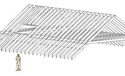

#4 One example attached used ArchiCAD's RoofMaker tool to frame a roof. Then you can get take off from it, out of the box.
