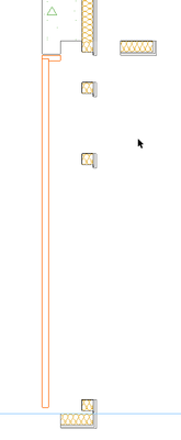

this is section
Why can't the beam be blocked by the door?
I copied the one on the right, but I can't see it

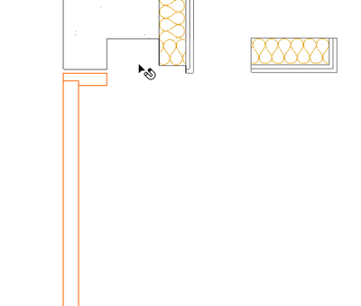

this is plan
this is beam
this is section
Solved! Go to Solution.

Building materials priority. You have to give your beam the same or higher priority for building material than the wall.

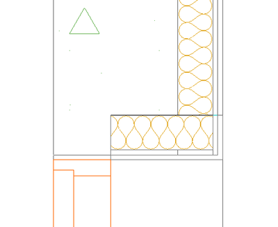

this is section
Then, how can I model the cross section like this?
In main menu choose Options/Element Attributes/Building materials, you can find there "Intersection priority" and give for building material of beam higher priority then building material of the wall.

2022-07-21 03:07 PM
Because the beam is invisible by intersection priority.
