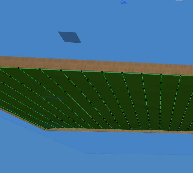

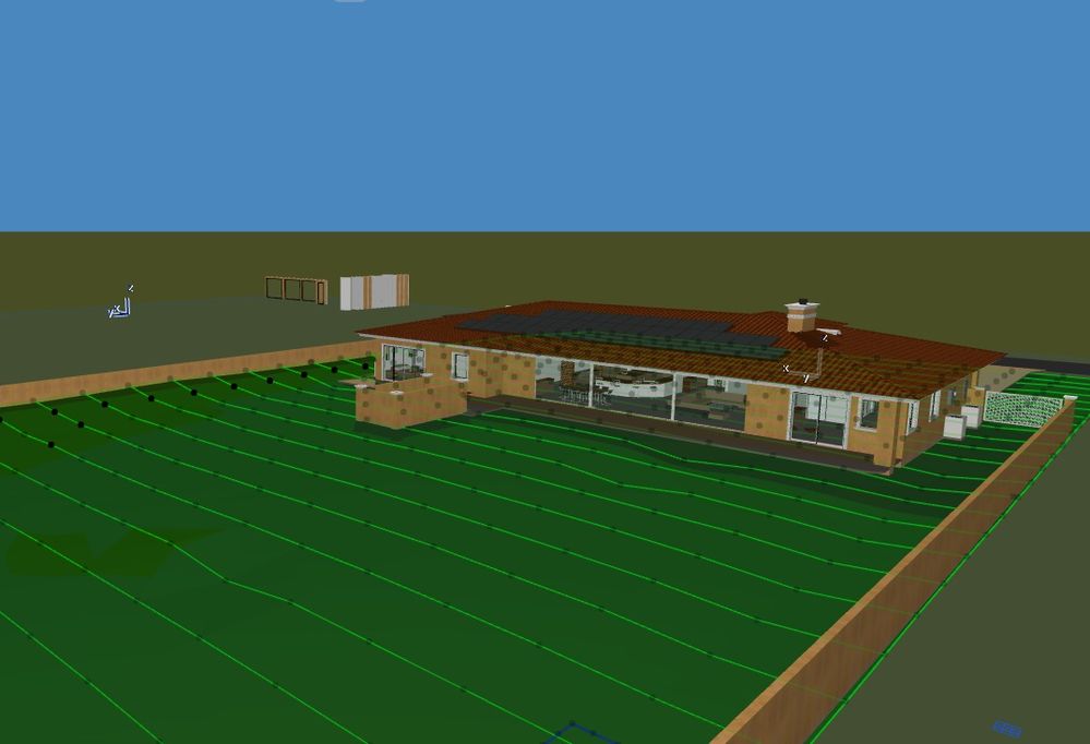

I guess sometimes my lessons are hard learned, but If I become more adept at the mesh tool it's well worth it. I went ahead with 3 or 4 hours of data input time to build this mesh and while it's pretty and everything it really does me no good in that it doesn't translate into good 2d documentation.
Going to do it over today with interpolated (intelligently guesstimated) splines at equal 1' intervals.
I guess I was thinking that there was a way to smooth out the mesh after creation. Like a sheet in the wind (curvilinear) as opposed to the faceted surfaces of a stealth bomber. Had this been possible with good results, I had envisioned morphing the mesh and slicing it horizontally into 1' contour sections. Maybe even 3" or 4" interval contours which might facilitate the new design in a situation like this where the site is sloped enough to require some grading but not enough to be easily visualized.
Does anyone know why some of the mesh nodes appear to be visible on the top and others on the bottom sides? Just curious as to what this might indicate. See screen shots.
You know what... I'm thinking go ahead and morph a copy of this mesh and see how it looks after being horizontally sliced into 3" contours.
Cant the morph of the mesh be smoothed out first? the results would have to be accurate enough I would think... Going to try this.
Bottom of the mesh screen shot
Well, the Morph Tool has a few editing commands that might work, like
Curve & Merge Edges
Smooth & Merge Faces
Modify Segmentation
When you try it keep in mind that you can select only a few Morph edges or only a few Morph faces and perform the command only on those. This may be useful info.
laszlonagy,
I did the entire morphed property at once (Curve & Merge Edges) and it seemed to work.
It's a one acre site and I did slices at 3" o.c. (see screen shot below)
It's not a very steeply sloping site (3' or so from highest to lowest points) kind of a sand dune in the desert sand belt. I'm amazed at how well the contours came out, will check the accuracy in the next couple of hours, but right now I'm thinking this is going to work.
Anyone have a comment regarding the partial visiblity of nodes from top to bottom?
