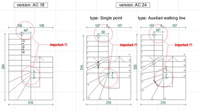

The biggest problem for me in Archicad (since version 21) is modeling a winder stairs. In the AC 18  it was easy, but in the last versions AC I unfortunately fail to model such stairs as in AC 18 and often I get the message like: "creating stairs in current parameters is impossible" however in version AC 18 it was possible (please, look at attached picture). According to our lokal standards, in the winder stairs, the depth of the step 0.25 m (in walking line) should be provided at a distance of not more than 0.4 m from the handrail of the internal balustrade, and winder steps should not come together in single point, only there should be a minimum distance between them, at least 3 cm for comfort. I usually need a staircase with a minimum distance between the flights of the stairs (about 0,5 cm, to save a space in the house). If I choose winder type : "Two Points method", or "Auxiliary Walking line method" or "Principal Lines method" and start model the winder stair with this parameters, I get the message like: "creating stairs in current parameters is impossible".
I have to confess that winder stair  in AC since version 21, works not good.
Because in AC 18 I modeled winder stair in 5 minutes, in AC 25 I have to spend more than half day and sometimes no result.
I would like to ask, if it is possible to model  winder stair with my parameters like in the AC18 version??? Please, look at attached 1st picture.
Below is winder stair in AC18

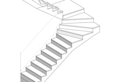

Below is winder  stair in 3D what  I want to model
