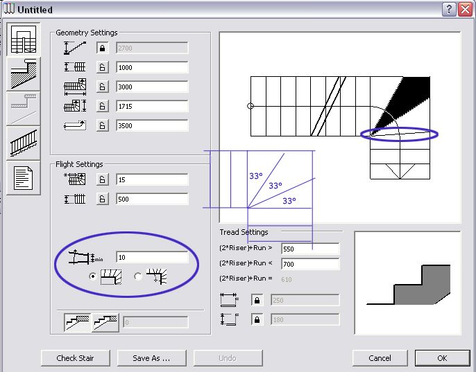

In Australia the building code states that the quater landing may include 3 winders, each winding 30°. Is there any way of creating this stair in Stairmaker? Every time that I try and create this type of stair using "L-Run winder at upper end" it rotates the last riser coming out of the winder and also keeps telling me that the solid stair slabs do not intersect. It seems as if Stairmaker is not capable of offering this service.

Unfortunately, it's not. We also frequently use winders and we have never been able to get the desired result. I usually use slabs for the winders and straight-run stairs to and from them. Time consuming, but the only way I can make them the way they are built.

Steve .... thanks for that .... it is what I ended up doing. It is a little slower and unfortunately the handrails get to be a pain .... oh well.
