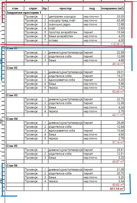

i have a question at the schedules part,
 this is the schedule that i made for apartment building until now is good but i need some more info things that we use at our city, and i want to adjust that here and to have it automatically in the future.
the red part has spaces outside of the apartments: stairs, hall, elevator etcc..
the blue part has all the apartment and is very good,

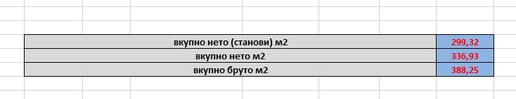

at the end i want to add 3 more columns like  this:
1. Total areas apartments m2 ( all the aparmtens m2 to be calculated in one row)
2. Total areas of the all apartments and all the other spaces in the red part in the first picture, (apartments area + stairs, elevator, hall etc)
3. Total m2 the whole slab of the building for example in ground floor.

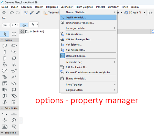

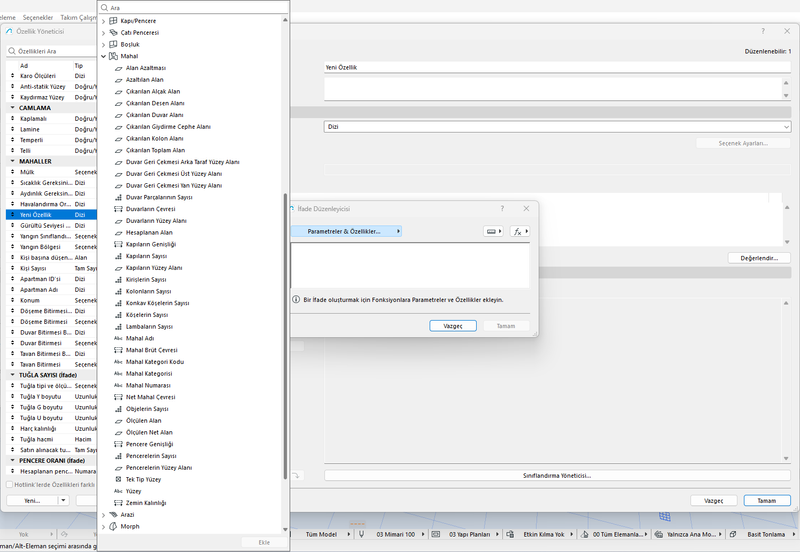

I'm not sure if you can see this directly in a single table, but you can look at the property manager and create a formula from there to perform these calculations automatically.
Similarly, in my country, there are some specific calculations. For example, areas like stairs and hallways are not included in certain calculations, and I need to exclude them. For this, I added a true/false property to the zone. If the zone's “exclude from calculation” property is true, it is not included in the schedules.
Similarly, modeling skirts in multi-apartment buildings is bad for optimization. For this, I prepared a special property that subtracts the width of the doors from the perimeter of the zones, and I can get data without drawing the skirt.
