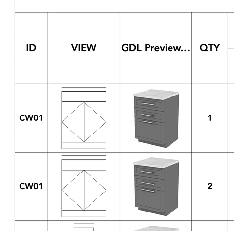

Is it possible to show a 3D cabinet in an ISO or parametric view place in a schedule once the cabinet has been modified to your preference.  Instead of the generic 3D view??  If not, let's work on this one.  🙂

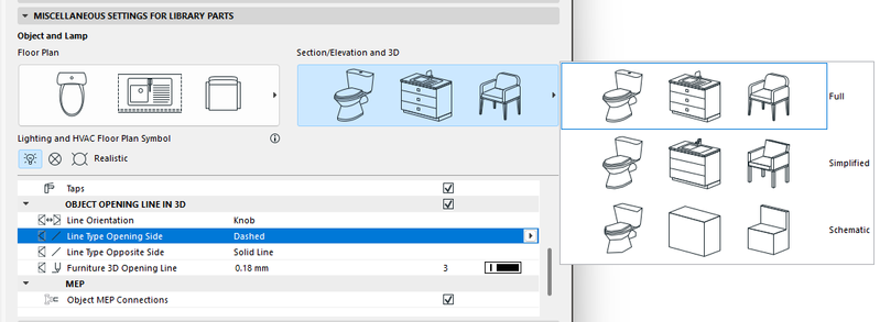

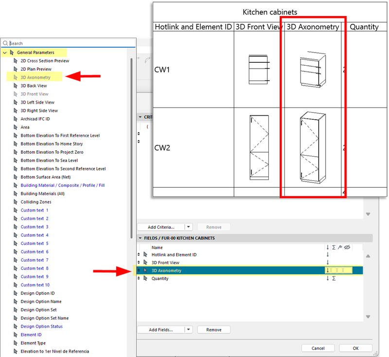

In the Scheme Settings you have to add the field: General Parameters> 3d Axonometry
When you create the view choose the correct MVO Combination to show the needed level of detail in 3D for those objects.
