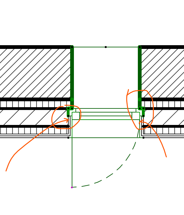

Hello,
Any ideas why the thick line gets interupted by the plaster which is thin? I use archicad 26.
Thank you in advance!
1 Reply 1
Hello @KorniliaP,
You need to define a finer pen at the level of the relevant layer in the composite structure of the wall.
