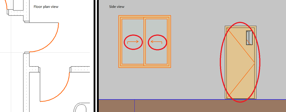

I have a problem with window and door opening marks..
In floor plan view, I can't change color and line thickness of a door opening. Below on the screen shot, you can see, I wish to have those orange lines black as the rest..
And another thing is, that I want to hide those symbols which mark in which way the windows and doors are opening. I want them to be hidden in side view and in the 3D view.. There's a screen shot of this below also..

Hatcher wrote:
I wish to have those orange lines black as the rest.. And another thing is, that I want to hide those symbols which mark in which way the windows and doors are opening. I want them to be hidden in side view and in the 3D view.
Hello,
Try going to Document > Set Model View > Model View Options > Options for GDL Objects. You can change the appearance of those lines from there.
Hope that helps,
Adrian Tudoreanu
Fixed both of my issues perfectly.
Thank you very much for your help, Adrian.
