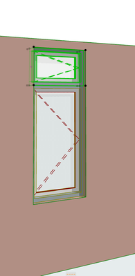

A question about AC22, but I think it aplies to other versions as well.
If there are two windows on the top of each other, is there a way of controlling which one of them is displayed "on the top" in plan?
I have two windows on the top of each other with different geometry in the file that which I'm working on at the moment and I need to display only the top one in plan. Is there a way of doing so?
So far I've only managed to do that if I place a new bottom window first and then the "top" one. But is there a way of editing existing ones? Ideally, I would like to avoid remodelling all such windows in my project...

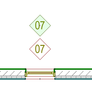

2023-12-01 05:12 PM
Got it. If you want to label both you could still set the "top" window display setting to "overhead all" and change it's overhead line type to dashed (or dotted if you want it "invisible"). It would still be selectable but would look more like one window for plan purposes, but with both still selectable and tags displayed. Screenshot below shows the "top" window with dotted overhead line. Hope that helps!
