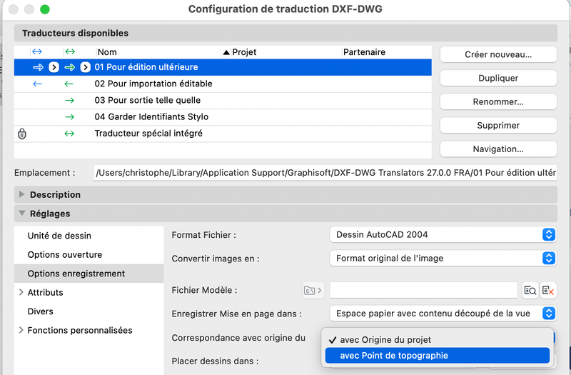

If ITM coordinates are X,Y,Z coordinates you have to place the localisation point at the ITM origin and modify the dwg export parameter about it.
And...
Sorry about the french interface. I do not find the right link on Graphisoft website.
