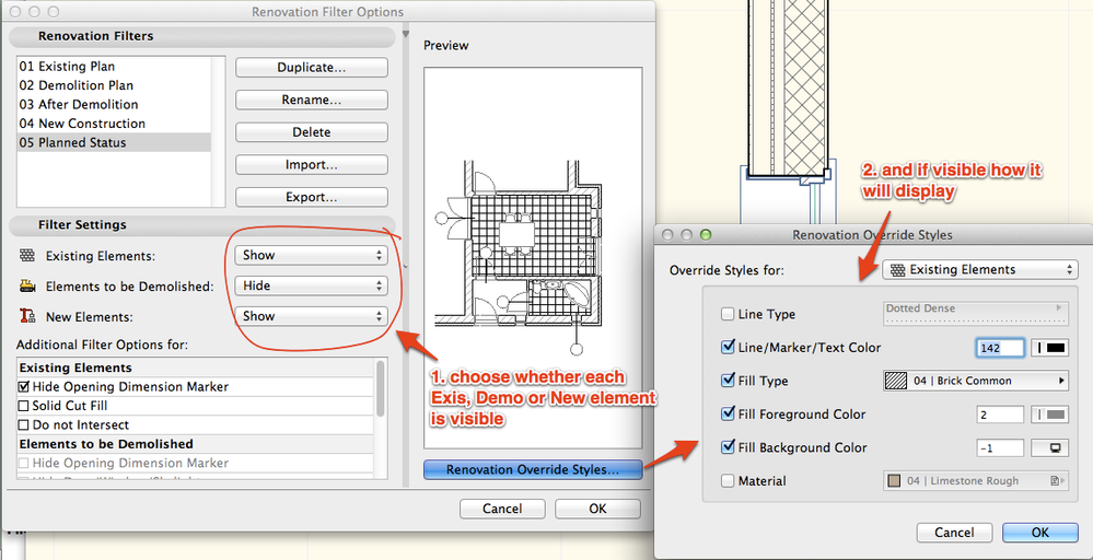

Hey, hopefully simple question here. Using AC16, current build and I can not get the stippled patterns to display or print. Example: 12 | Carpet pattern on a zone does not display. Example 2: 09 | Gypsum Board pattern does not display or print in my composite walls. How do I get those patterns specifically to display and print? Have on-screen view options set for vectorial patterns to be on already with no change. When I turn it off, the bitmap patterns do show but of course the tile patterns don't display properly because you just have that little preview block is the pattern size.
Also, I am using Construction Documents model view option with New Reno filter. Seems like I have missed a global setting somewhere but I can't figure it out, even after looking at the manual for an hour.
Any ideas? What am I missing??
5 REPLIES 5
Erika Epstein
Check your Renovation Filter Options. You can set the display of Existing, Demo and New elements as you want.
Document>Set Renovation Filter Options>Renovation Filter Options
On the Renovation Override Styles button you can set how you want each of these to appear

Erika,
Thanks but I am not certain that is the issue. Attached I have used Horizontal 4" fill, wood end grain fill, 12x12 grid and structural concrete fills as the cover fill of the zone element and they show. But I used the 12 | Carpet fill on the 056 Zone and it doesn't show. Also, note that the stippling pattern with the concrete fill doesn't show.

erika,
Thanks for trying though. Weird problem. I assume that your patterns show properly so it must be something with my setup. I will see what else I can tweak.
