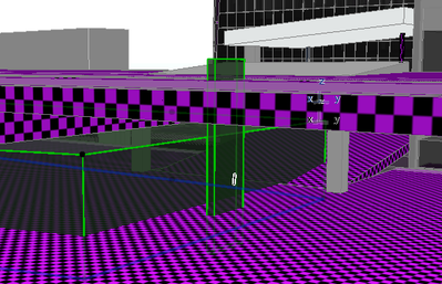

Some created zones have a strange geometry appearing as an additional element. Not possible to delete or change it in any way. Appears both on plan views and 3D. What is causing it and how to get rid of it?

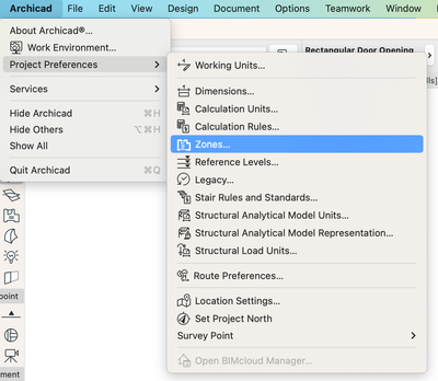

Is it where the zone extends in to a door or window opening? You can control this through Project Preferences - Zones by changing the parameters for the extension of the zone in to window and door recesses. See attached screenshots. These are from Mac but windows should be the same.

It is not with connected with opening therefore changing the parameters is Project Preferences did not help.
Even when I move away the zone area, this small piece still persists with its own height.
