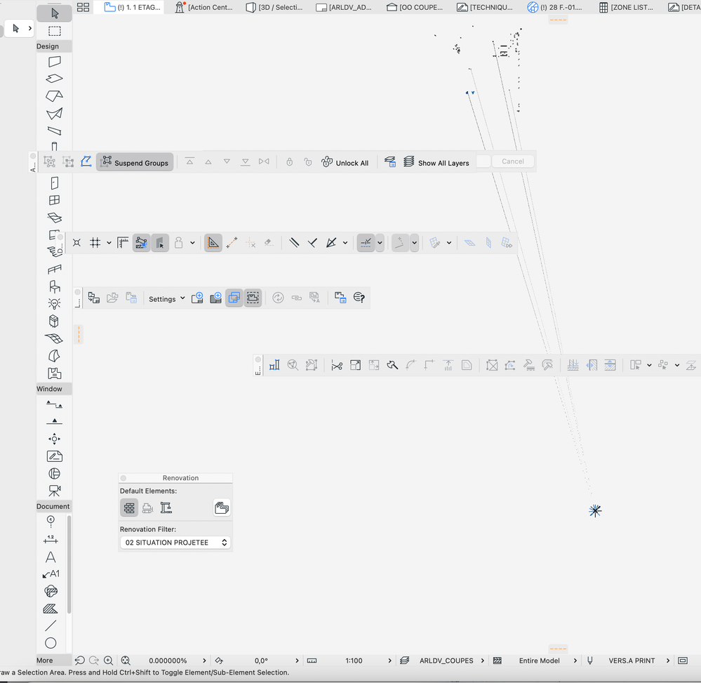

I have a been working on a project for quite a while and suddenly, I cannot zoom on my plan. It seems the zoom level is stuck on 0.000000% and even if I change this to 100% it will not zoom on my drawing. It looks like an origin problem but I have no idea how to fix this as I can't even select individual elements.
Cross linked with dotted lines to faraway plan...Cross linked with dotted lines to faraway plan...

Had the same problem. It was triggered by an accidental change in orientation. After changing the orientation to standard, everything started working fine.
OSCARS
Thanks! That worked.
