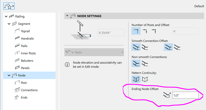

Hi everyone,
Does anyone know how to adjust the railing so it stops at the desired endpoint? It’s currently extending a bit further than I need it to.

ananas:
Take a look at the Ends settings. Be sure you have the correct part selected at the top of the dialog box.
David

JeffH
Could also be this setting that needs adjusted

Hi, thank you both.
I found it:
Not sure why, but I could not set to zero, but first write a bigger number and then I could lower it ...

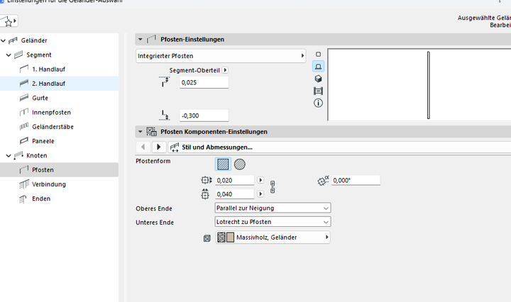

I have one more struggle.
I would like to align the edge with the other ailing bars, but now sure where to find this settings to push it a bit back?
