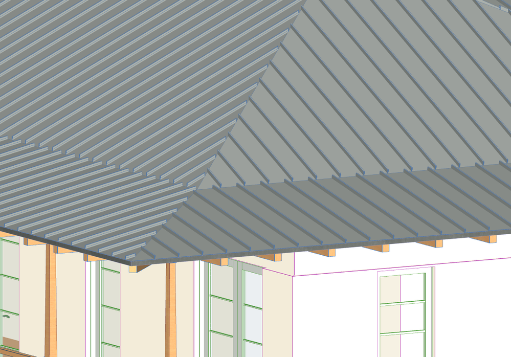

alignment for standing seam metal roof accessory
Is there a way to adjust the seam locations to line up on my split pitch roof? I want the seam from the upper section of roof to continue in line down along the lower roof section

I haven't used that for about 7 years, but I vaguely recall that it positioned itself based on the starting point and direction the roof was built. I think I had the most luck when I used just one roof and copied/mirrored it around to make my entire roof system.
It may have changed since, but perhaps give that a go until someone else replies?

It's been a while for me too but as I recall the start point is relative to the roof reference line center point.
If there is a better way to model standing seam roofs, I am all ears....
but as for using this, my reference lines are centered already

The only better way I know of is to purchase the Cadimage addon. An alternative is to model the seams as little bits of roof though this is obviously a pain to maintain.
The reference line can be moved laterally to reposition it's center reference point without affecting the position or slope of the roof. If I recall correctly this should reposition the start point of the seams.

Duane Valencia first published the tip on adjusting the roof pivot line position to align the standing seam roof accessory. Long time ago, but repeated here:
http://archicad-talk.graphisoft.com/viewtopic.php?p=21019#21019

Thank you for the tips, apparently now in 14 adjusting the pivot point only effects the 2D, there is no change to the 3d. Frustrating...

Glad you tested it... I just tried it in 14 and found that the 3D would update for me only if the roof and accessory object were mirrored ... and then only for the mirror. The original, un-mirrored accessory updates its 2D symbol in response to adjusting the pivot line, but not the 3D. The mirrored copy updates both.
(Only adjusting the "left" endpoint of the pivot line makes any changes. I'm defining "left" as if you have drawn the pivot line and clicked the eyeball away from you. So, for a normal, positively pitched roof, it is the "left" of the three pivot line points when looking at the lower edge of the roof.)
I'll pass on the bug to GS... Even though Accessories are "not" supported, I hope they'll fix this...

Regarding the bugs with the standing seam accessory object, Graphisoft reports that this is already in their queue of wishes and issues.
