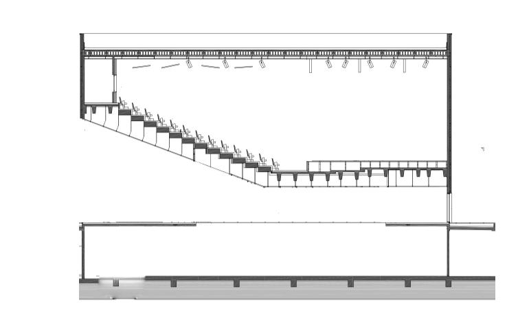

Hi Can anyone please help , im trying to create a custom roof for a thatre and cant for the life of me work it out, any help would be greatly appreciated.

IMHO , it really depends on what level of details you are going to do:
you could draw using the slab tool ( giving it the roof thiknes) and then detach the section from the model and draw the details in 2D.
OR using the complex profil using the hatch tool draw the details and then apply the profile to a beam anD thus you will have the detail in 3d .
hope it helps

thanks for that, is as complicated as it sounds, im new to Archicad, as you see from my model i need to tilt the floor on the third floor, i was told that i should do a custom floor?? i dont know where to start?
TMA_80
are you talking about the sloped part , if so, have a look at this totorial about complex profiles use :
http://www.aecbytes.com/tipsandtricks/2006/issue12-archicad.html

Don't give it up. All of these programs take time to learn. You have several posts here asking about modeling and theaters are among the more complicated to model. Think about how the building is going to be built.
How much training have you had? Have you gone through the training videos? Is there an archicad user group near you? Is there another archicad user near you (UK as a location is a bit general)?
When I look at the roof, I see the ceiling, above it joists and above them the roof decking. If the roof is an plane, sloped or flat, you can make a custom profile. And/or you can model the elements separately e.g. the joists which you can use SEO's to subtract their volume from the roof composite...

I was just logging in to correct my earlier post. With intersection priorities you can often avoid the SEO command and get a clean differentiation between elements.
