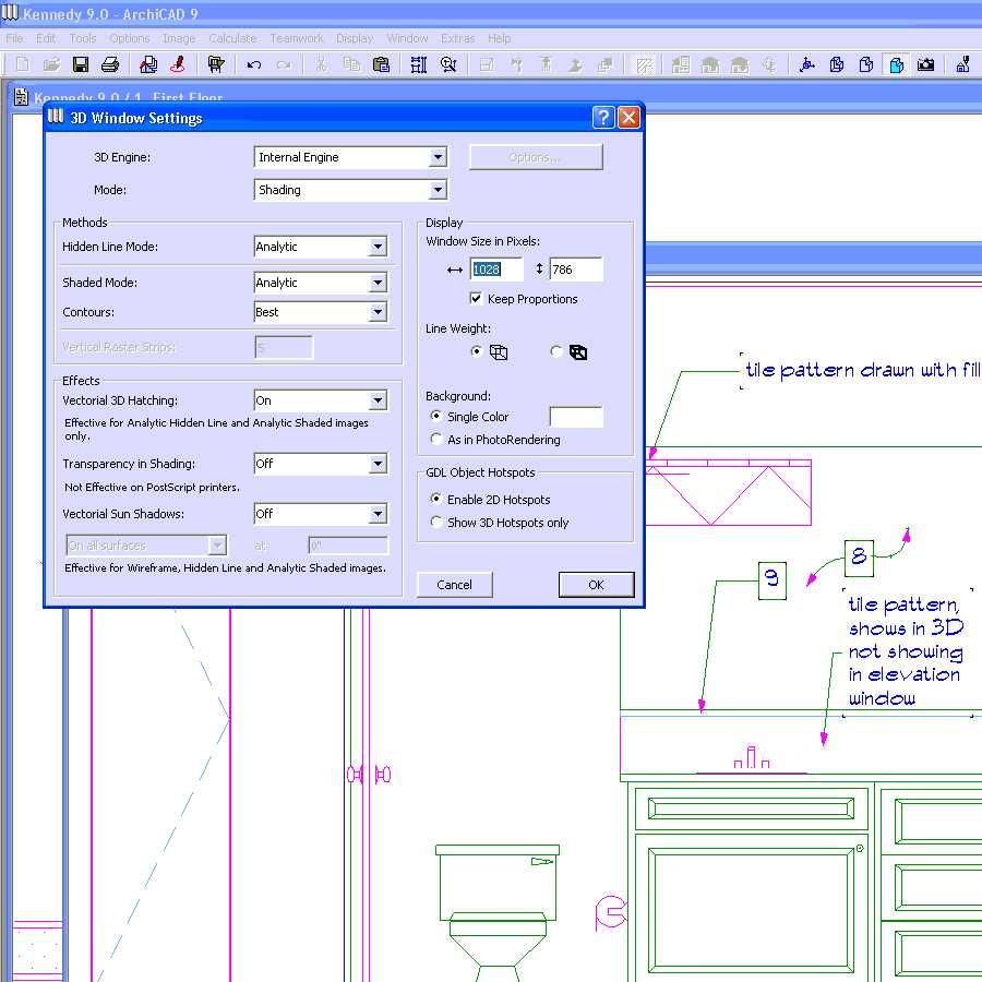

How can I get the applied fills to show in section/elevation windows?
I have the "vectorial 3D hatching" checked. What (obvious) setting am I missing?
thanks

Hi Erika,
Have you turned it off in the Options/Display Options menu? Cause this has an effect on plan view and section windows ...
Check your Drafting Fills/Cut Fills settings' (if it's part of a 3D element that is)
Aussie John
Erika, there is a check box in the actual sections settings
Cheers John

Erika Epstein
oh how embarrassing.
Susanne and John thank you for all your help.
