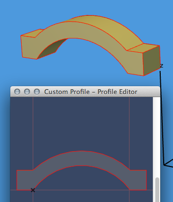

Dwight
So you are using the morph approach, then.
The quickest way would be to use a complex profile on a floor plane, convert to morph, then stand it up.

Tom Krowka
Here is what the profile looks like. I want to run it in the XY axis, then stretch the top in the Z axis to form a curve. I know I can use the masonry arch object, but it will only do brick, not stucco. Can't get rid of the brick lines.
This can't be that hard, can it?

Dwight
You can make it an object like in the olden days, but it is easy to stand a morph up.
