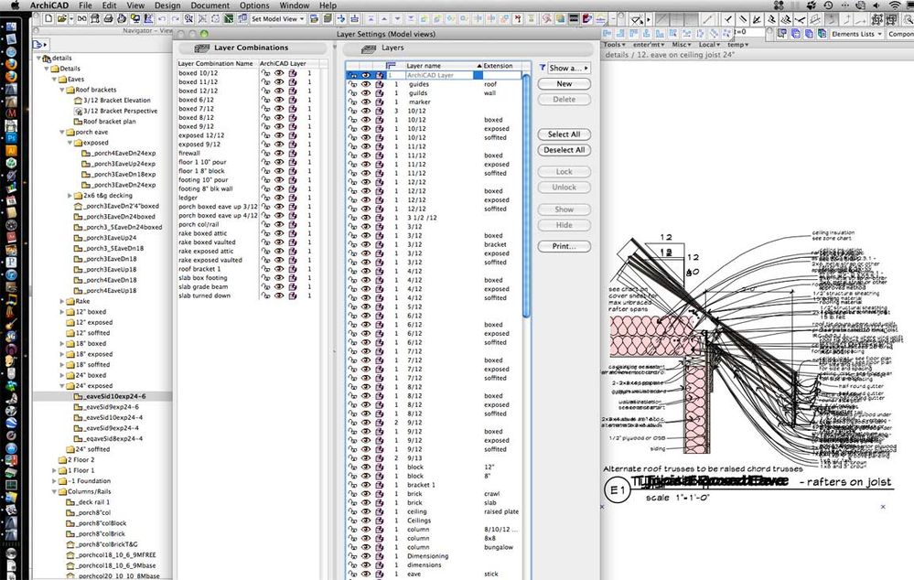

I keep all details parked in one pln. I combine laying and stories to generate multiple details without changing most of the components of the details. I currently have about 40 stories. I'll attach a screen shot. It allows me to quickly generate, and maintain (ie code changes) by changing one note for all variations (say of a roof detail and all pitch configurations. I keep many details on my template file, but new ones are easy to drop onto the layout via. organized as the pln is auto linked when opening any pln I have.
I find it important to have the source file Absolute Path as opposed to Relative Path, and manual update. I tend to copy plns and move a variation to another folder, so this keeps the details linked. These are important considerations. When I need a variation of a detail is easy to copy and paste the base detail on a blank section (or similar) and make changes... or simply add a white fill over the placed detail (or often in the case of different text make the new text have a white fill).
There is potential for this detail pln to go insane, but so far it has worked great for my work.... however, I have gone insane.
