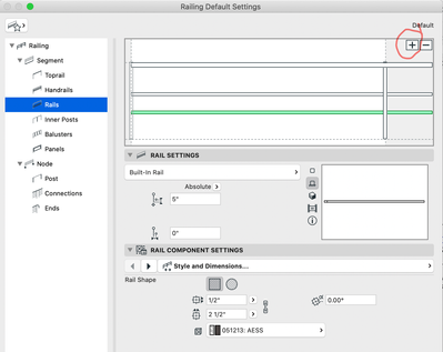

Yes it's a finicky tool, but you can do a lot with it.
To add a new element you need to go into the segment / scheme portion of the object settings, select the sub-element type you want to add and then press the '+' key in the upper right corner:
To delete a sub-element you select it in the segment / scheme preview and press the '-' button.
It's worth playing around with all the settings in these complex tools to figure out how they each work (curtain wall, Railing, stair etc.).  They are each like entire programs in themselves.  It can be frustrating learning process and the Graphisoft documentation could be a lot better than it is, but once you know how they work you can model complex systems pretty efficiently.  Favorites are essential for these tools...to save you from having to recreate the same things over and over again.  You can save favorites of entire objects, and you can save favorites for individual sub-elements.  It's well worth the time for objects you will use now and then.

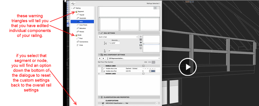

If you have modified any individual segments or nodes of the railing so they are different to the overall settings, you will see a little yellow warning.
It is possible to reset them back to the overall settings without having to recreate the entire railing.
but i need to make those individual modifications. and when i do i get the warning. so, then i reset them, make changes with the object settings, then go back and make the changes to the individual sub elements. what a pain.
thanks Kelly.
MAC Studio 2022 M1 Max, 32 GB RAM, 10 cores, AC27 5030 Apple Silicon USA Sequoia 15.3. AC 27, 6000 USA
Yes it is a pain.
Once you start editing individual components, you are better to keep editing individual components.
You can select multiple components and edit them all in one go - just as you can in the main model.
