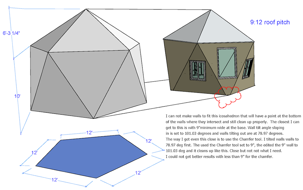

I am trying to model an icosahedron and can't get the walls to clean up properly.

would you like to see the model and some elevations?

i'd like to see the model and its elevation if available

I should have some very interesting stuff to show in a day or two. I have to get this project out the door first. Then I can fuss with it enough to show off some very very clever modeling. Things that have not been possible with ArchiCAD until version 16. And this is a real project too.
