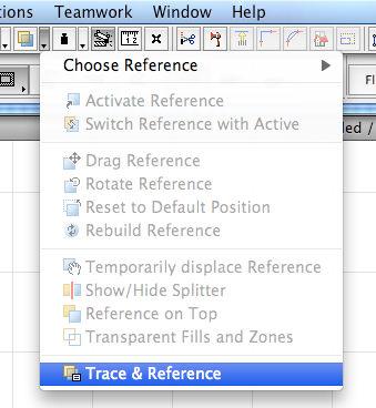

click the icon upper like this.
here you are.
