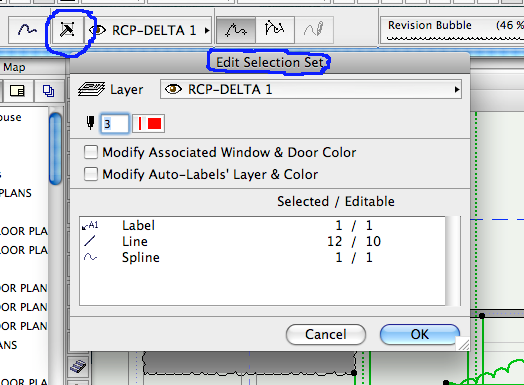

Stress Co_
Or use the "edit selection set" shortcut: (Hammer in a square icon, in the Info Box).
