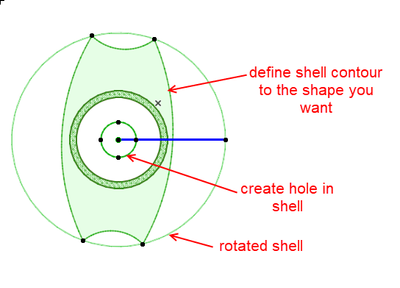

Maybe a rotated shell?
You can define the shell contour in plan (draw circles, trim them and then magic wand).
Create a hole (draw circle and magic wand).
