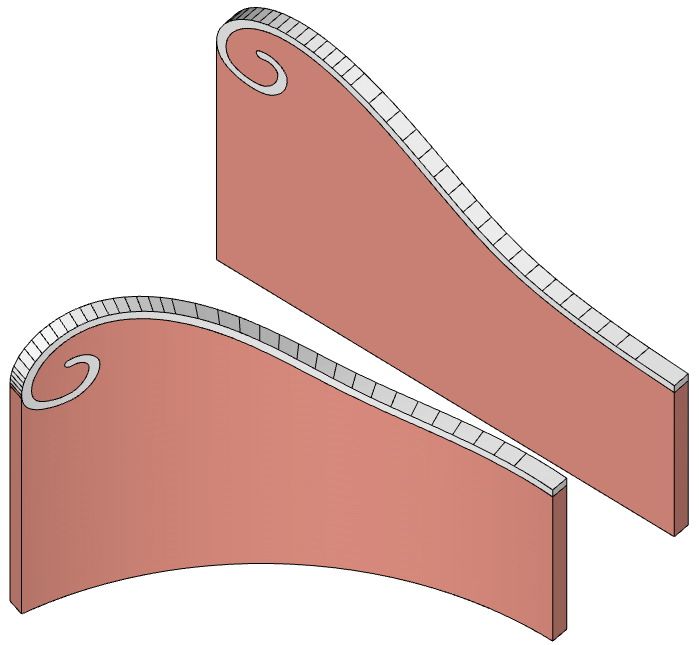

Take a look at OBJECTiVE. It will make this task very easy. I simply selected the shapes you drew, created an Elevation profile for it with OBJECTiVE > Component > New Profile. You can so this directly in an elevation view to draw it in situ. These profiles can also be bent to a curve (see image).
Ralph Wessel BArch
Central Innovation
