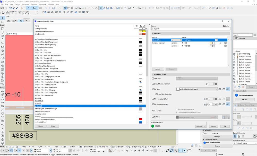

Is it possible to graphically override skins of composite structures in a different way.
IN my case I would like to get concrete to be black while thermal insulation transparent.
I used those two rules that are presented in attachment abnosivi.jpg and ti.jpg.
3.jpg is result. I get everything black or everything transparent. It depends which rule is on top of GO. (GO.jpg)

mzex wrote:
Is it possible to graphically override skins of composite structures in a different way?
Short answer: no, it's not.
Long answer: Yes, with a little work.
Sorry for the german; I did this for the german forum.
On top: no GO.
second: GO - only foreground pen
third: GO - only background pen, overriden with blue
The insulation has 0 as background pen.
Why it works.
