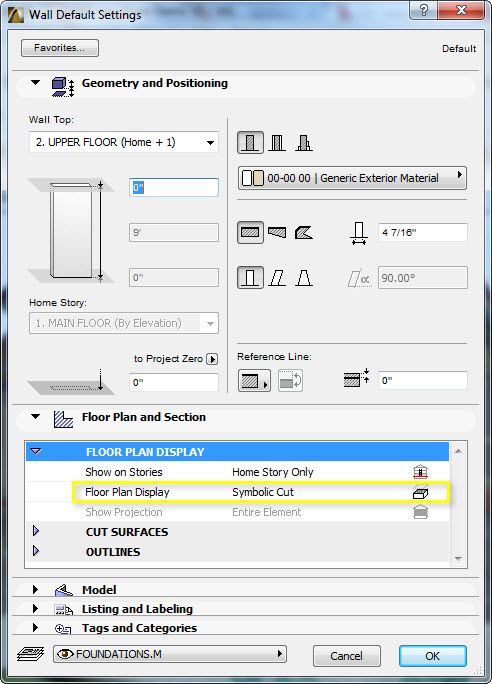

Check the Floor Plan Display.
Unfortunately it is not available for my red walls.

igreere:
Change the parameter above it, Show on Stories to Home Story Only, and the Symbolic Cut option will appear. This will ignore the Floor Plan Cut Plane, so is the simplest solution if the Walls only appear on their home story and always will be shown as cut. The All Relevant Stories option is best used for multistory Walls, or when using the Floor Cut Plane for changing the Wall's appearance for different Views.

Thank you. That solves it.
