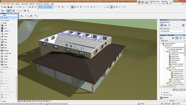

how do you model this roof?
this is an L shaped one-sided hip roof. One leg of the L is narrower than the other. I made it by doing a regular hip roof then dragging the ridge over to one side on both legs. But the corners of the hip were not at 45 degrees so I started dragging nodes around to get it to look right--but this was all by eye. There's got to be a more precise way.

In a nutshell, just set the edges of the roof that are touching the house to be gables. Another approach is to pretend that the upper story isn't there, and then subtract the roof at the second story using the pet palette. Hope that's clear.
