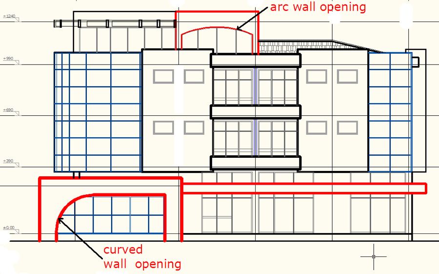

create curved opening in a wall
I wanted to create the curved arc like opening as seen in the pic below don on AutoCAD.In the terrace floor I need a rectangular& an arc opening for a curtain wall to be inserted, in the ground floor veranda like element I've a large opening with both rectangular & curved opening when we see it in perspective.
My problem is how to get that curved like opening.
Please help me soon.
Many Thanks

heynock:
For the upper opening, you can use the W Arch Opening 14 window. For the lower opening you can combine the W Arch Opening Half 14 and W Rectangular Opening 14 windows.
David
David Maudlin / Architect
www.davidmaudlin.com
Digital Architecture
Thanks Dave,
I thought there could be another way of editing the element.
Or, the other method is to create the side view of the opening using a Slab.
Then set its ID to "WALLHOLE".
View it in Top Parallel View in 3D (Viewpoint at 270 degrees) and save the 3D as a Window. File\Libraries and Objects\Save 3D Model As command.
Save it as a Window.
Then you will be able to place it into the Wall.
The "WALLHOLE" ID will cause the slab to be interpreted as a hole.
