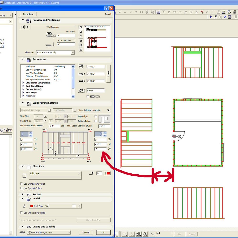

It could be these two settings.

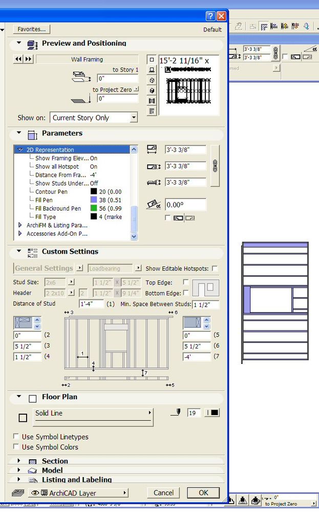

Steve Jepson
and this one?

gooseman wrote:
First, you are using archicad 9, so things are a bit different. Also, we set upm our screen to look like your and still got only half the wall to show studs. My students created walls by using wall icon from the toolbox. Now they are trying to toggle between seeing studs and not for location purposes but they can't. It appears as if you are in windows accessories which means having to recreate the walls? yes. you must use the wall accessories object to create studs automatically. Under wall framing settings (which is our custom settings), we don't it to preview like yours. you will when you togle the "Show Framing elevation" option Also, not sure if you created the multi-views behind it or not but we can only create a top view. just turn on the "Show in elevaton feature" Please advise on the best way to make walls so we can see them with or without studs when we need to (also, how do we toggle between them).

Below are some pictures of some settings that work. with 8.1.0 R2 USA (2284)
Draw walls-select walls-click Extras-Accessories-Wall Accessories-select the Wall Framing object-configure-save as a Favorite-click OK-your cursor will turn into an eye-click anywhere on the screen and it will generate your wall framing. To control the display just turn toggle the layer the objects are on, on and off.

more settings
Steve Jepson
...more settings you probably dont need me to show you.
