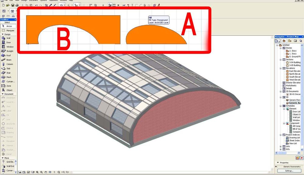

HI ALL
1- I try to made that curved wall ( in up )
I try with profile A I nave the the wall but I cant open windows or door in it
I try again with normal wall and use SEO with profile wall B I have the wall but I cant see correctly it in plans
2- any way to draw profile up the curve with archicad tools .
thank you

Dwight
Make a plain wall instead.
Use the Solid Element Operation tool to trim away the excess.
The operator will be your arched roof elements.
This wall will support conventional openings.
Dwight Atkinson
Erika Epstein
The Curtain Wall can trim a regular wall by connecting it.
Select wall & Curtain Wall
Design>Modify Curtain wall>Connect Wall
see note on attached screen shot. As in other areas of archicad when a curve turns back on itself what you are trimming with it may have to be split into two, or else break the curtain wall into appropriate sections.

thank you I know about connect wall but never done but spilt is good idea I try it to right part and left part and cut the wall but the middle part make some problem I will try again . thank you
for curved roof not allow me to do that because some part of this cw come under another part but I will try to split this roof to 2 roofs thank you all
but
