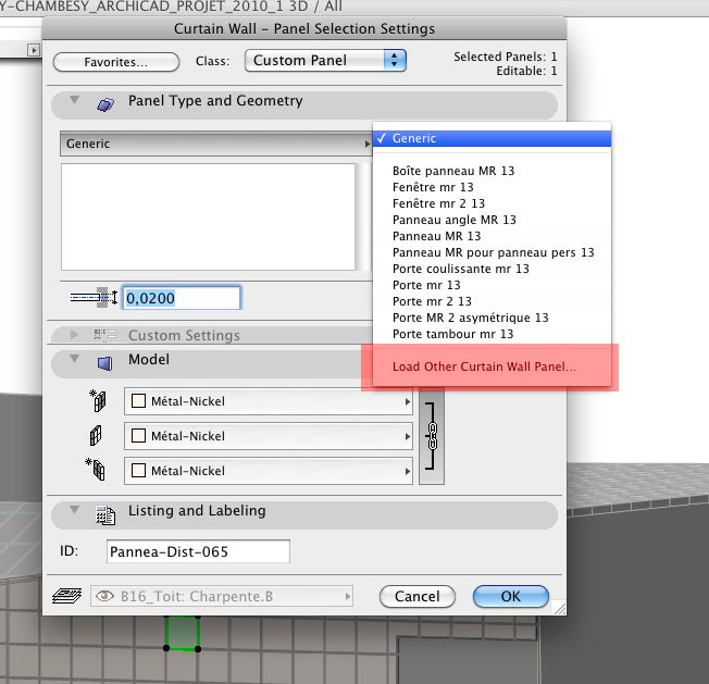

I am learning archicad, and i have a question concerning the way of customizing curtain walls components;
i understood the way of changing mullions by gdl objects saved as "cw structure or anything else", but i don't understand the mechanism of the red underlined menu illustrated here...
Could you explain me what sort of file does it refers to?
Thanks

David Maudlin
Rockstar
stef52:
This will allow you to browse your hard drive to find parts that are not in your loaded libraries.
David

David wrote:
stef52:
David
Thanks you David, i didn't notice that it could be a .gsm file...
So, i want to create a panel with a rotation variable to draw a claustra... the problem is that i don't have this rotation variable into the panel menu; what is the method to input this? must i entering a script in the panel?
