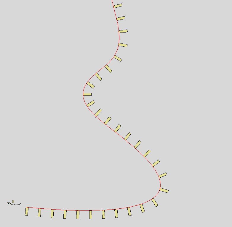

kliment wrote:
And it helps a lot to have this: 😉
Do you think you can get by with just casually dropping that one?
Does it multiply along a line and/or polyline/spline?
AC 25 SWE Full
HP Zbook Fury 15,6 G8. 32 GB RAM. Nvidia RTX A3000.
vistasp
Mats_Knutsson wrote:
Sadly, arexline.com has disappeared. Mats, this is from the user guide:
The rxDuplicator tool allows you to create and place several copies of the selected elements along a path. A path is an open or closed curve or its part. As a path, you can use any 2D drawing elements: line, open and closed polyline, circle, arc, elliptic arc, open and closed spline. Grouped segments of 2D elements. Any contour of polygonal elements: slab, zone, hatch, mesh, roof.
Using tool settings, you can distribute duplicates along the path according to the number of duplicates or the distance between them. You can also apply vertical displacement to the created duplicates either at the specified step or up to a certain value as well as automatically place each duplicate at the level of the slab, roof or mesh below it. Besides, each duplicate can be rotated at a tangent to the path.
Kliment, does this plugin work with AC12 too?
= v i s t a s p =
bT Square Peg
https://www.btsquarepeg.com
This was just a teaser! And a reminder for Graphisoft to implement it!
It is called rxDuplicatior and is for AC10. Sorry, no version for AC12!
Mats, you can multiply along anything, even splines! Objects can even rotate themselves according to the path.
In fact, rx add-ons are the only reason I still keep AC10 on my computer!
Dwight
There is a compromise. Since the sinuous curve is a fantasy, and a real building would have facets, when you put the glass down, do it with the magic wand set to a specific linear segment length. Then follow around placing and rotating the ribs.
