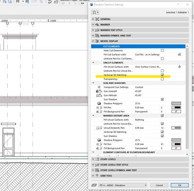

If your fill (hatch) is assigned to your material and not showing up, make sure vectorial 3D hatching is turned on in your Elevation settings (Elevation tool), and for 3D window check the 3D window Settings, where hatching is only available in Internal Engine mode (not OpenGL).

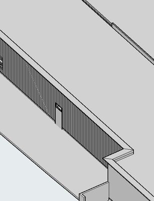

I too am struggling with hatching this morning.
I cant seem to get Archicad to show the hatch.
My settings are:
Elevation Settings

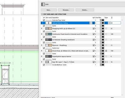

Wall Settings:

It does work in 3D however, just not in elevation.....

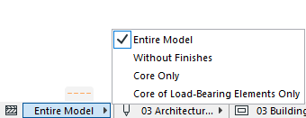

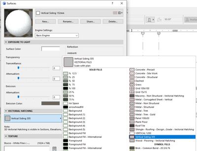

The material Vertical Exterior Siding is set as a finish in the composite. Is the Partial Structure Display for the elevation view set to Entire Model?
Johann_P
Thanks,
You pointed me in the right direction:
I had some "Graphic Overrides" on that followed from the plans..... (novice error, really)

GOs are in hindsight more likely to be the issue than PSD - but as long as it got solved.
