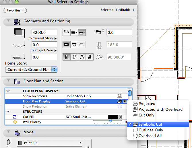

Make the walls show as "Symbollic cut" in Floor Plan Display setting, and doors and windows will always show as if they are cut by the Floor Plan Cut Plane.
