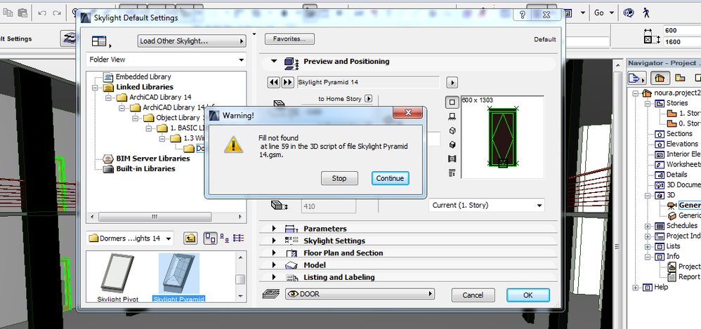

error in object : Skylight !?
hello everytime i try to make a skylight i get this error please help me what should i do and where can i download the skylight again cause i cant find it??
its a msg written : fill not found ! at line 59 in the 3D script of file skylight pyramid14.gsm and i've tried them all and it gets me the same msg?
any ideas?

xpepsigirl:
Your problem is similar to the one discussed in this thread:
Library Parts Not Working Properly
You need to go through the skylight's parameters to find the missing fill and select one that is part of your PLN file.

thank you 😃
