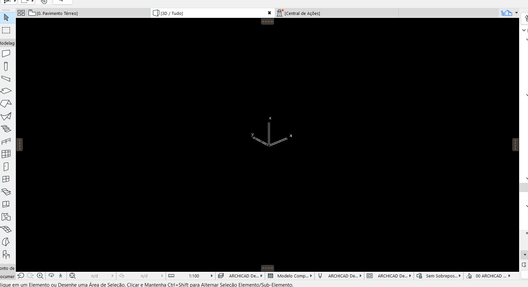

hello my program when requesting to generate the 3d project is presenting this black screen error , could someone help me ?

What are your computer specs and AC version.
Did it work previously?
Update your drivers?
New file?
Looks like an OpenGL issue.
Switch your 3D window style to use the 'Vectorial Engine'.
If the model shows up then, you know it is an OpenGL (Hardware engine) issue.
Then either your machine specs are insufficient or you may just need to update video drivers.
