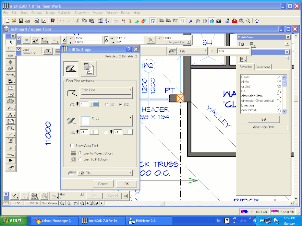

this is getting me crazy....
i am trying to get the PT to show as a solid white on the dark wall. i have checked to make sure the fill is white solid fill.
the print came out to be the same dark color as the wall in a black and white print.
did i miss anything?

It looks to me like you've selected a 50% fill - make sure you've selected "solid fill" in the second box down. If you still have trouble arrange for the fill to "move forward". It should print OK if it looks OK.
I've found that generally speaking, things print better if you go with solid fill and just use pen colours to create white, black and shades of grey. This seems to work well with HP colour plotters straight from AC & Plotmaker and with PDF files.

thanks....just before i got your notification, i found what happened.
i print the plotmaker file to a pdf and i noticed there is a box-all colors to black- checked . So, i changed all the symbols fill to EMPTY instead and now, there are all showing as solid white over the dark walls.
